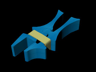

Thanks John. Here's a rendering of the straight version for the reversed linings if anyone wants to see it.
John Watkins
CNC Guitar Parts

Quick question John. What is opening size when the clamp faces are parallel?
I laminate my sides and it just occurred to me that with that extra width I
might run into a problem with the clamps pinching at the top and not
closing down evenly on the lining. I might have to make my linings a bit
narrower, and that's fine. Just wondering.

PostPosted: Fri Jul 28, 2006 4:50 am
Posts: 2687
John, I have the same question as Dave.

Right now, as drawn, the opening is 3/8". It's not too late to change that, however, if there's a better way for everybody.
The little guys will go for the same price since the real cost is in the cutting, de-burring, and anodizing which is charged per piece. So figure $120 for 50 big guys and 10 little guys.

Keep the drawing John! 3/8" opening is dead on perfect for my needs.
Don, as I understand it, the clamping faces are 1/2" wide, 5/8" long, and
parallel at 3/8" apart.

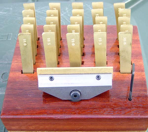

Hey folks,
Remember these??
John's work is first class all the way, so if you think you can use some of these kerfing clamps jump in while you have the opportunity to pick these up at a great price. If they are anywhere near the quality of his fret cauls you will not be disappointed.

Good idea about the colors, Kim, and thanks for the endorsement. Nice holder!

John, I'm unclear about the advantage of having flat-faced clamps that are parallel at one specific opening width (I'm thinking of the reversed kerf type here). If one varies the thickness of one's sides, or sometimes adds laminations to the sides, it seems that one would often end up with a clamp that is pinching at the top or bottom of the lining.
Am I missing something here? I would think that jaws with somewhat rounded faces (or ability to swivel, or some other mechanism that keeps them parallel at any width of opening) would be the ticket.

Todd, that was my original thought, which was why I asked about what the opening was designed for as far width when the sides are parallel.
Curved faces...not a bad idea actually Todd.

Todd, my thinking was that the clamps would designed for the widest opening anyone would want. For clamping smaller thicknesses, you could just run a piece of scrap purfling or binding around the outside.   The curved piece is an appealing alternative, but I don't think it would clamp as effectively as the flat one when everything is parallel.
Moving parts such as a swivel are out of the question because of expense. Even adding $.25 to each one becomes a heck of a lot of up front money because we have to make thousands of these to meet the minimum order.
To put it in perspective, I'm planning on 3 people working for a solid week to put the tension bands on them. It's a lot of clamps.
Besides, the extrusion dies are already in production.
